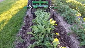

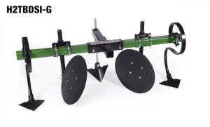

Heavy Hitch makes this simple product.

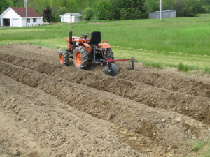

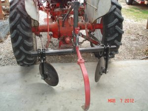

A DIYer has made this for a simple 3PT 8N.
I already have the sq bar. It's the perfect length as my drawbar to slide inside and mount onto. I'll need to buy the coned like discs, a few brackets and U-bolts.

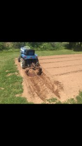

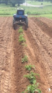

That SCUT is doing a great job hilling!

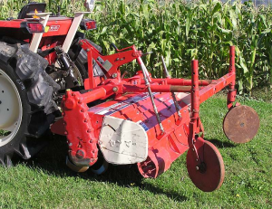

I really wanted a Yanmar 3PT PTO tiller that comes with the hiller discs that are extended out the back of the tiller. I typically turn up goose eggs in a 200 mile radius search looking for one. RS1702 or a RS1601.

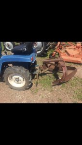

Here’s my hiller.
