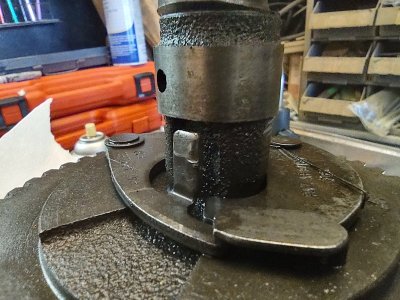

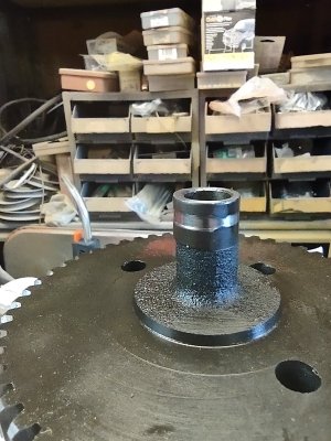

Due to compression leak, found with leak down tester, I decided to take the engine apart and do a rebuild. This is a k241 out of my Minneapolis Moline 110. The cam has a lot of wear in the area the points rod runsIMG_20230901_102952979.jpgand also on the compression release tabIMG_20230901_103012058_HDR.jpg. I have a used cam to replace it with, but has anyone else come across wear like this? This is a early engine, it has a metal governor gear vs plastic.The piston and cylinder had normal wear.

I guess just make sure that points rod floats freely, Ted! Can't imagine how that could have gouged that old crank so badly!
